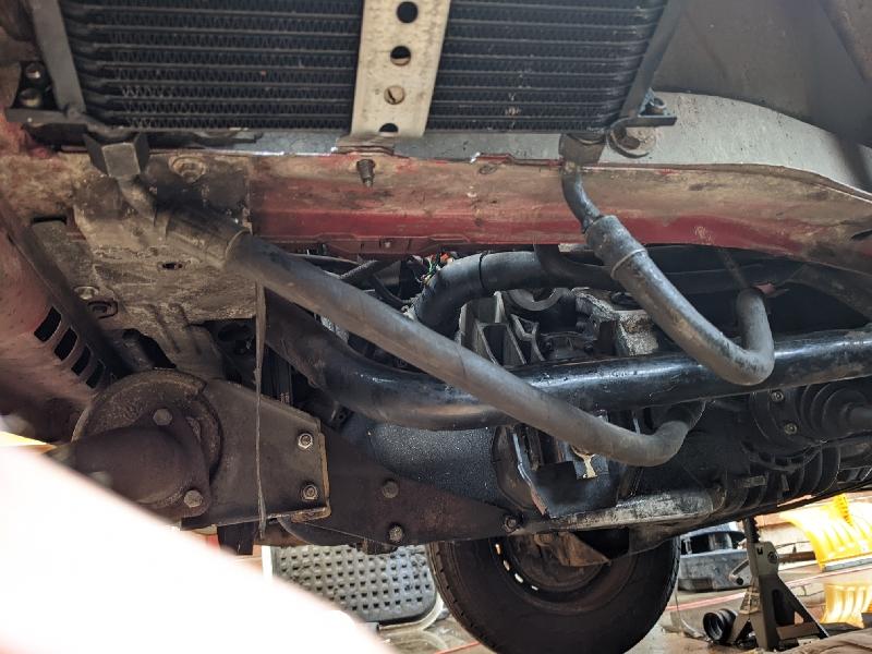

Greetings all. It has been a little while, but work has begun on the bus. My friend and I spent last weekend updating all of the shift linkage bushings and installing new axle seals. I have run into the problem of my transmission oil fill plug is rusted so I have been battling trying to get that out. I also found some isofensters from a shop that had them from a wrecked T3. https://www.thesamba.com/vw/forum/viewt ... 6&start=20

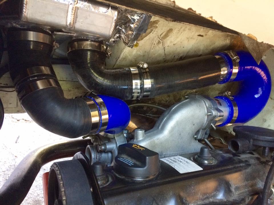

Good Evening,
I have added a LLK and an oil cooler to my JX, I think the oil cooler is too small and I will need to upgrade
I have also updated my pump a la Oettinger.
Next steps are to replace the turbo and refresh the motor.
I would like to what modifications I can do to increase the power so that I can use air conditioning in the future. What injections nozzles do you use that will produce more fuel reliably? I have heard that GTD nozzles produce 170bar and I have read about Citroen XUD nozzles. I know that the K14 turbo is used from the factory, but it may be easier for me to find a Garrett T3 turbo from a Passat/Golf/Jetta, however I think I just need to re-clock the housings in order for it to work. There is also a company in Canada called Giles, who is known for rebuilding IDI injection pumps that yield + 30 horsepower. With all of these modifications to the JX, will it remain reliable? What do bulliforum users do to produce more reliable power from their JX motors?
